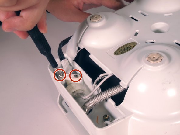

  2. Black and Decker The ShellBaker Meal and Dessert Maker G400 Disassembly: crwdns2935265:02crwdnd2935265:01crwdnd2935265:03crwdne2935265:0 Black and Decker The ShellBaker Meal and Dessert Maker G400 Disassembly: crwdns2935265:02crwdnd2935265:02crwdnd2935265:03crwdne2935265:0 Black and Decker The ShellBaker Meal and Dessert Maker G400 Disassembly: crwdns2935265:02crwdnd2935265:03crwdnd2935265:03crwdne2935265:0
    • Open the ShellBaker such that the outdented pan surface is facing up, and the handle is facing toward you.
    • Remove the two 12.7mm screws on either side of the handle using a Phillips #2 screwdriver.
    • Remove the handle from the ShellBaker.

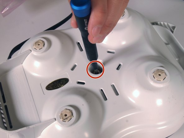

  3. Black and Decker The ShellBaker Meal and Dessert Maker G400 Disassembly: crwdns2935265:03crwdnd2935265:01crwdnd2935265:02crwdne2935265:0 Black and Decker The ShellBaker Meal and Dessert Maker G400 Disassembly: crwdns2935265:03crwdnd2935265:02crwdnd2935265:02crwdne2935265:0
    • Orient the ShellBaker so that the back end is facing you.
    • Remove the 19.1 mm screw located above the bottom stand using a TR25 Torx Security screwdriver.
    • The top of the lid should now be detached from the top part of the pan and the circuitry on the top should be revealed.

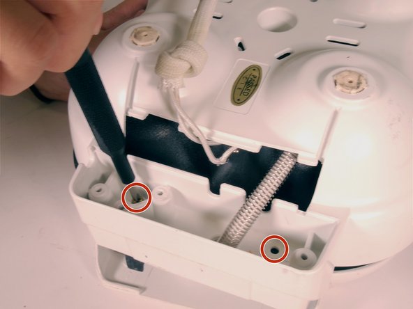

  4. Black and Decker The ShellBaker Meal and Dessert Maker G400 Disassembly: crwdns2935265:04crwdnd2935265:01crwdnd2935265:02crwdne2935265:0 Black and Decker The ShellBaker Meal and Dessert Maker G400 Disassembly: crwdns2935265:04crwdnd2935265:02crwdnd2935265:02crwdne2935265:0
    • Flip the ShellBaker over so that you are looking at the bottom of it.
    • Remove the two 12.7mm screws on the end opposite the handle that attach the bottom stand to the base of the machine with a Phillips #2 screwdriver.

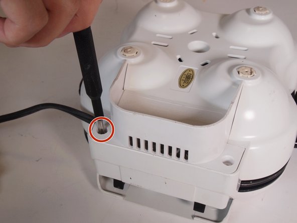

  5. Black and Decker The ShellBaker Meal and Dessert Maker G400 Disassembly: crwdns2935265:05crwdnd2935265:01crwdnd2935265:02crwdne2935265:0 Black and Decker The ShellBaker Meal and Dessert Maker G400 Disassembly: crwdns2935265:05crwdnd2935265:02crwdnd2935265:02crwdne2935265:0
    • Remove the bottom stand from the base of the machine.
    • Remove the two 12.7mm screws on the clip that keeps the power strip in place using a Phillips #2 screwdriver.
    • Remove the clip to release the power strip.

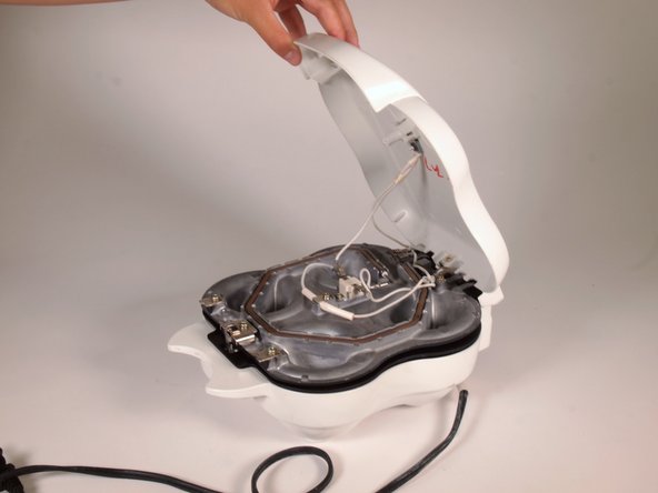

  8. Black and Decker The ShellBaker Meal and Dessert Maker G400 Disassembly: crwdns2935265:08crwdnd2935265:01crwdnd2935265:01crwdne2935265:0
    • The lid and base of the ShellBaker should now detach and you should be able to view the circuits of the machine on the top and bottom.
  9. Black and Decker The ShellBaker Meal and Dessert Maker G400 Disassembly: crwdns2935265:09crwdnd2935265:01crwdnd2935265:01crwdne2935265:0
    • Circuit Diagram for the ShellBaker
