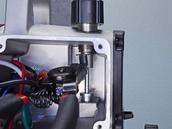

Remove the retaining ring
  • Use snap ring pliers to remove the retaining ring from the top of the plunger.
  • During reassembly, install a new ring with the flat side facing down.
