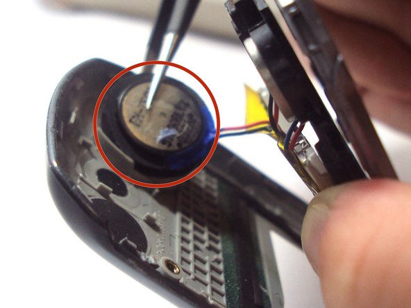

  • Using tweezers, pull the vibration motor away from the outer grey casing and towards the black plastic surrounding the screens.
  • The vibration motor is adhered with glue, so it may take some force to pry it off of the outer grey casing of the phone.
