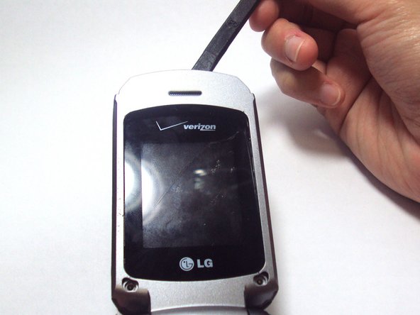

  5. LG VX5600 LCD Screens Replacement: crwdns2935265:05crwdnd2935265:01crwdnd2935265:02crwdne2935265:0 LG VX5600 LCD Screens Replacement: crwdns2935265:05crwdnd2935265:02crwdnd2935265:02crwdne2935265:0
    • Hold the opened phone upright.
    • Use the spudger to pry around the edges of the phone and detach the tabs.
    • Make sure all the tabs around the grey cover are detached. They are located on the top and on both sides of the screen.

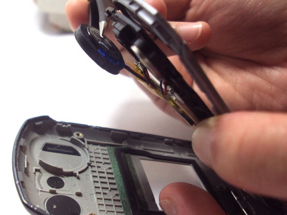

  9. LG VX5600 LCD Screens Replacement: crwdns2935265:09crwdnd2935265:01crwdnd2935265:02crwdne2935265:0 LG VX5600 LCD Screens Replacement: crwdns2935265:09crwdnd2935265:02crwdnd2935265:02crwdne2935265:0
    • Using tweezers, pull the vibration motor away from the outer grey casing and towards the black plastic surrounding the screens.
    • The vibration motor is adhered with glue, so it may take some force to pry it off of the outer grey casing of the phone.

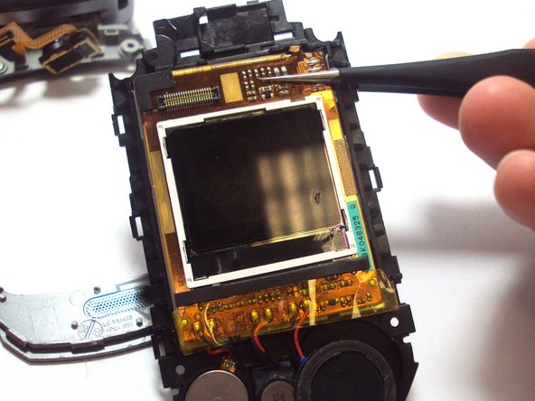

    • Remove the green tape that covers the end of the yellow flex cable.
  12. LG VX5600 LCD Screens Replacement: crwdns2935265:012crwdnd2935265:01crwdnd2935265:01crwdne2935265:0
    • Grasp the phone with one hand, and use the tweezers with the other hand to pull up on the flex cable disconnecting it from the screen.
  13. LG VX5600 LCD Screens Replacement: crwdns2935265:013crwdnd2935265:01crwdnd2935265:02crwdne2935265:0 LG VX5600 LCD Screens Replacement: crwdns2935265:013crwdnd2935265:02crwdnd2935265:02crwdne2935265:0
    • Use your fingers to lift up the detached flex cable and use the tweezers to lift the LCD screen component out of the phone casing.
