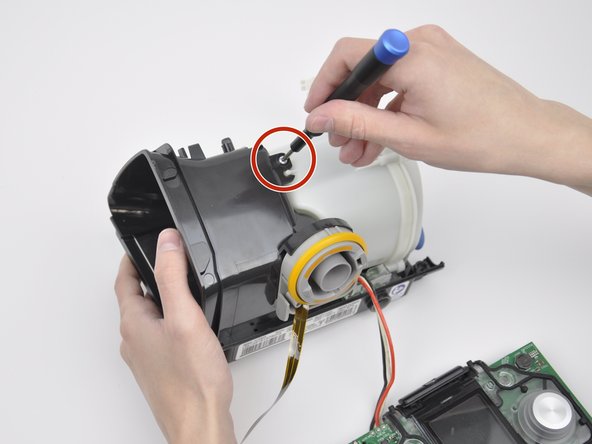

  • Remove the 14 mm TR10 Torx screw (located above the air outlet port) from the water tank housing.
  • Hold the black plastic body of the device and slide the pump housing away from the body.
  • The underside of the pump housing and the device chassis have corresponding rails (marked with the orange rectangles) that must be aligned when removing or replacing the pump housing.
