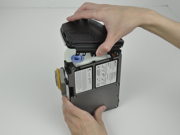

    • Remove the water tub by gently pulling it out.
  2. ResMed AirSense 10 Motherboard Replacement: crwdns2935265:02crwdnd2935265:01crwdnd2935265:03crwdne2935265:0 ResMed AirSense 10 Motherboard Replacement: crwdns2935265:02crwdnd2935265:02crwdnd2935265:03crwdne2935265:0 ResMed AirSense 10 Motherboard Replacement: crwdns2935265:02crwdnd2935265:03crwdnd2935265:03crwdne2935265:0

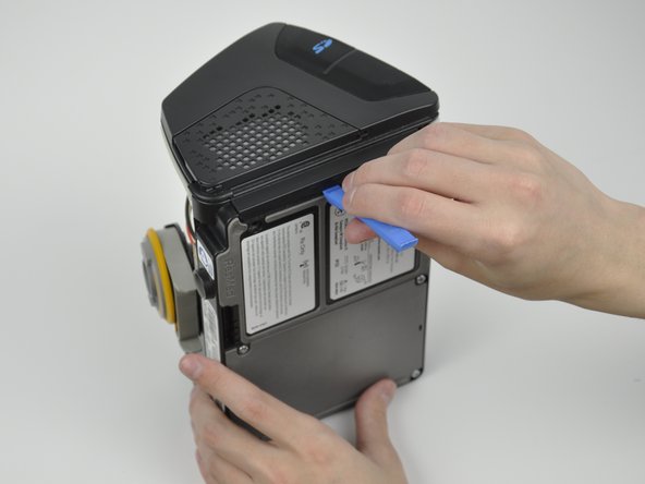

    • Pry off the face plate by using your finger or an opening tool.
    • Use a moderate amount of force when prying open.
    • Remove the face plate from the top cover.
    • There will be a clicking sound on either side of the divot when assembling and disassembling.
  3. ResMed AirSense 10 Motherboard Replacement: crwdns2935265:03crwdnd2935265:01crwdnd2935265:02crwdne2935265:0 ResMed AirSense 10 Motherboard Replacement: crwdns2935265:03crwdnd2935265:02crwdnd2935265:02crwdne2935265:0
    • Unscrew and remove the two 11.8 mm TR10 Torx screws that were revealed from the face plate being removed.
  4. ResMed AirSense 10 Motherboard Replacement: crwdns2935265:04crwdnd2935265:01crwdnd2935265:02crwdne2935265:0 ResMed AirSense 10 Motherboard Replacement: crwdns2935265:04crwdnd2935265:02crwdnd2935265:02crwdne2935265:0
    • Unscrew and remove the two 11.8 mm TR10 Torx screws from the bottom of the device.
  5. ResMed AirSense 10 Motherboard Replacement: crwdns2935265:05crwdnd2935265:01crwdnd2935265:03crwdne2935265:0 ResMed AirSense 10 Motherboard Replacement: crwdns2935265:05crwdnd2935265:02crwdnd2935265:03crwdne2935265:0 ResMed AirSense 10 Motherboard Replacement: crwdns2935265:05crwdnd2935265:03crwdnd2935265:03crwdne2935265:0
    • Remove the top cover from the rest of the device.

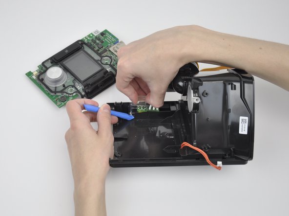

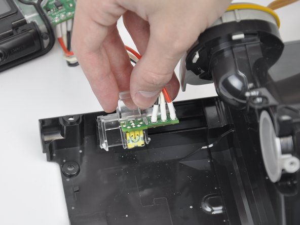

    • Insert a halberd spudger behind the black connector on the white wires from the wireless communication board.
    • Apply gentle pressure away from the motherboard to the black connector.

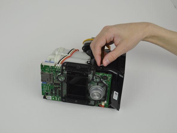

  8. ResMed AirSense 10 Motherboard Replacement: crwdns2935265:08crwdnd2935265:01crwdnd2935265:03crwdne2935265:0 ResMed AirSense 10 Motherboard Replacement: crwdns2935265:08crwdnd2935265:02crwdnd2935265:03crwdne2935265:0 ResMed AirSense 10 Motherboard Replacement: crwdns2935265:08crwdnd2935265:03crwdnd2935265:03crwdne2935265:0

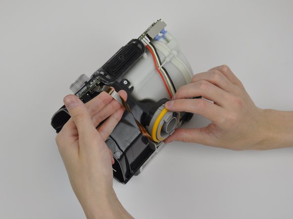

    • Rotate the outer ring of the air outlet port counterclockwise to provide slack in the ribbon cable.
    • As the ribbon cable becomes slack, you can put a finger under it to support it and gently pull the cable upwards from the frame.
    • Do not pull the ribbon cable more than an inch and a half from the top of the black plastic housing. Pulling the ribbon cable too far could damage it.
    • Grip the thin sides of the hard plastic tab on the end of the ribbon cable which connects to the motherboard.
    • Gently pull the hard plastic end of the ribbon cable upwards from the top of the motherboard, and wiggle it slightly from side to side to disconnect it.

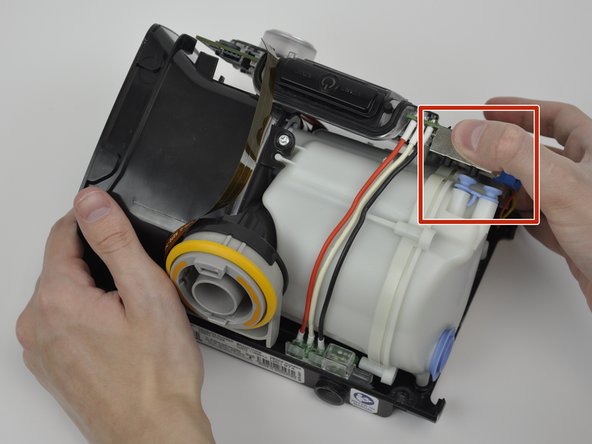

  9. ResMed AirSense 10 Motherboard Replacement: crwdns2935265:09crwdnd2935265:01crwdnd2935265:02crwdne2935265:0 ResMed AirSense 10 Motherboard Replacement: crwdns2935265:09crwdnd2935265:02crwdnd2935265:02crwdne2935265:0

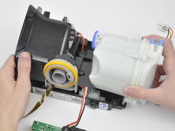

    • Slide the red, white, and black wires out from under the plastic tab on the top of the pump housing.
    • Gently pull the silver case away from the pump housing to disconnect the two small pipes.
    • When reassembling the device, make sure that the blue rubber adapter is in place.

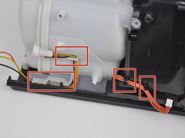

    • Make sure that the wires are held in the clips (shown in the red rectangles) on the pump housing and chassis when reassembling the device. This will keep the wires from interfering with the position of the motherboard.
  11. ResMed AirSense 10 Motherboard Replacement: crwdns2935265:011crwdnd2935265:01crwdnd2935265:03crwdne2935265:0 ResMed AirSense 10 Motherboard Replacement: crwdns2935265:011crwdnd2935265:02crwdnd2935265:03crwdne2935265:0 ResMed AirSense 10 Motherboard Replacement: crwdns2935265:011crwdnd2935265:03crwdnd2935265:03crwdne2935265:0
    • Remove the 14 mm TR10 Torx screw (located above the air outlet port) from the water tank housing.

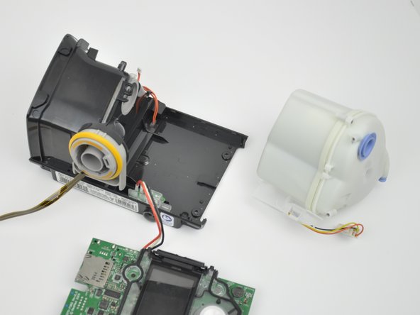

    • Hold the black plastic body of the device and slide the pump housing away from the body.
    • The underside of the pump housing and the device chassis have corresponding rails (marked with the orange rectangles) that must be aligned when removing or replacing the pump housing.

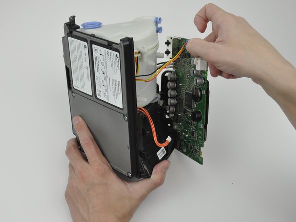

  12. ResMed AirSense 10 Motherboard Replacement: crwdns2935265:012crwdnd2935265:01crwdnd2935265:03crwdne2935265:0 ResMed AirSense 10 Motherboard Replacement: crwdns2935265:012crwdnd2935265:02crwdnd2935265:03crwdne2935265:0 ResMed AirSense 10 Motherboard Replacement: crwdns2935265:012crwdnd2935265:03crwdnd2935265:03crwdne2935265:0
    • Place the device with the air outlet port facing away from you.
    • Press the clear plastic clip (on the left-hand side) towards the air outlet port using one of the opening tools.
    • Apply pressure upwards on the clip with the opening tool to disengage the clear plastic clip from the corresponding clip on the black plastic body of the device.
    • Apply moderate force to the square clear plastic tab towards the air outlet port while also pulling the square tab upwards.
    • Remove the motherboard from the chassis of the device.

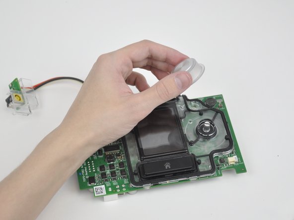

  13. ResMed AirSense 10 Motherboard Replacement: crwdns2935265:013crwdnd2935265:01crwdnd2935265:02crwdne2935265:0 ResMed AirSense 10 Motherboard Replacement: crwdns2935265:013crwdnd2935265:02crwdnd2935265:02crwdne2935265:0
    • Pry the knob away from the screen cover plate using a spudger or opening tool, while supporting the opposite side of the knob and pulling it upwards and away from the cover plate.

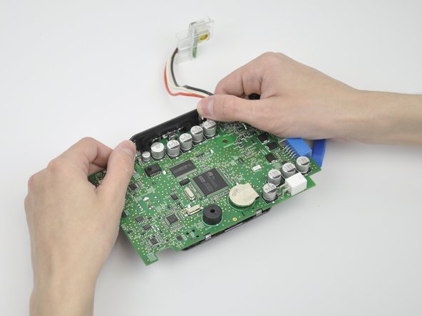

  14. ResMed AirSense 10 Motherboard Replacement: crwdns2935265:014crwdnd2935265:01crwdnd2935265:03crwdne2935265:0 ResMed AirSense 10 Motherboard Replacement: crwdns2935265:014crwdnd2935265:02crwdnd2935265:03crwdne2935265:0 ResMed AirSense 10 Motherboard Replacement: crwdns2935265:014crwdnd2935265:03crwdnd2935265:03crwdne2935265:0

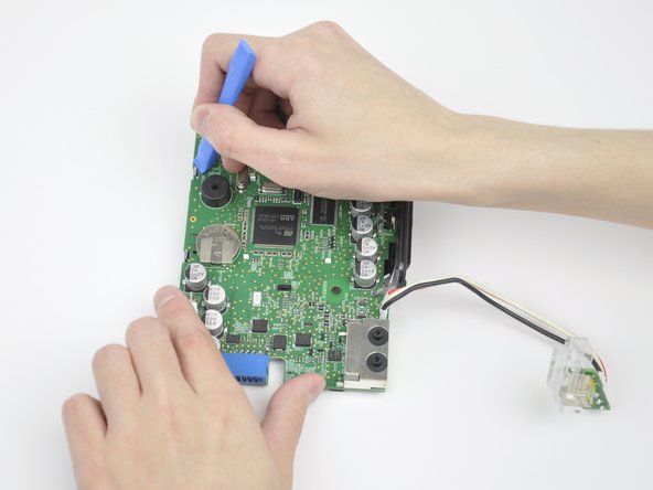

    • Apply pressure to the two protruding clear plastic tabs on the long edge of the motherboard using an opening tool, to unclip them from the motherboard. Gently press downwards on the top of the tabs and lift upwards on the motherboard until the tabs sit slightly below the level of the circuit board and no longer clip the board in.
    • Repeat the procedure to unclip the tab on the shorter edge of the motherboard.
    • Repeat the procedure to unclip the tab in the center of the motherboard.
    • Be careful that the opening tool does not slip along the motherboard. This could damage components on the board.
    • Push the screen cover plate away from you using your thumbs until it clears the top of the motherboard.
