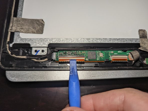

  • Use the flat end of a spudger to flip up the latch on the left connector.
