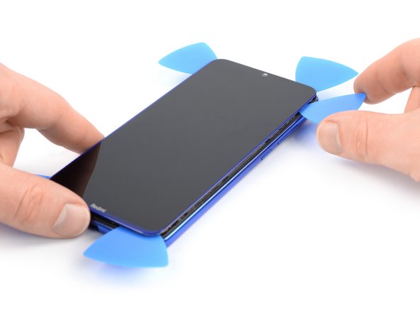

  • Insert a fifth opening pick and slide it along the right edge of the phone to slice the remaining adhesive.
  • Do not try to remove the display all the way yet, the display cable is still threaded through the frame.
