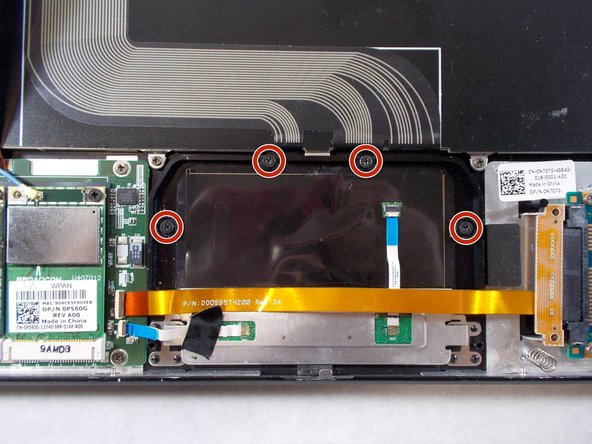

  • Using the Phillips #0 screwdriver, remove the four 2 mm screws securing the touchpad to the device.
  • Remove the touchpad from the device.
