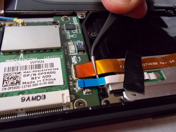

    • Disconnect orange film wire harness from the slot it is connected to.
    • The bottom cover and battery are one piece and will be replaced as a unit.
    • Remove the battery from the device.
