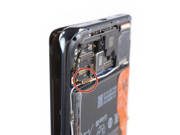

Remove the screen
  • Thread the display flex cable through the gap in the midframe and remove the screen.
  • Apply new adhesive where it's necessary after cleaning the relevant areas with isopropyl alcohol (>90%).
  • During reassembly, follow this guide in case you're using a pre-cut adhesive card.
