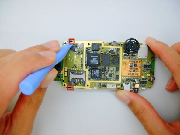

  • Use a plastic opening tool to lift up the two black clips indicated in the picture.
  • Hold on to the keyboard while unfastening the clips.
  • The keyboard will detach once the clips are unfastened.
