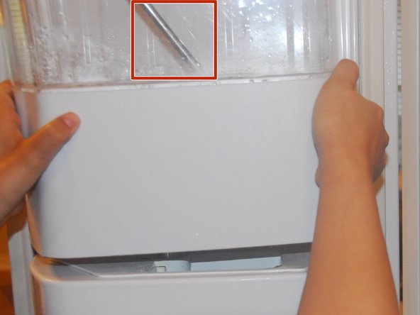

  • Return the ice bucket to the freezer.
  • If the ice bucket does not seat securely, rotate the auger slightly.
  • Once the auger is aligned with the motor coupler, place the ice bucket on top of the motor surface.
  • Let the ice bucket cool for 10-15 minutes to cool to its original temperature. This will prevent ice from clogging the dispensing chute once the ice maker is turned on.
  • If you chose to preserve the original ice in Step 3, return it to the ice bucket once the ice has cooled.
