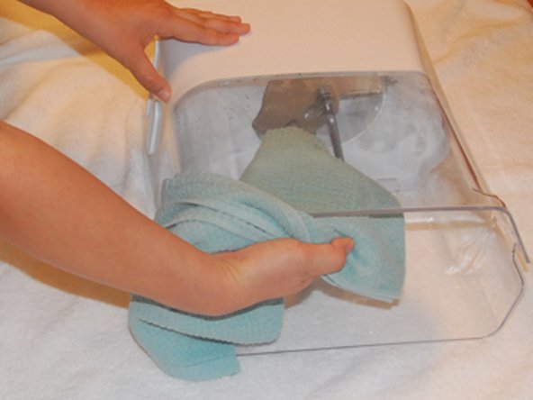

  4. How to Clear the Ice Dispenser in a Whirlpool Refrigerator: crwdns2935265:04crwdnd2935265:01crwdnd2935265:02crwdne2935265:0 How to Clear the Ice Dispenser in a Whirlpool Refrigerator: crwdns2935265:04crwdnd2935265:02crwdnd2935265:02crwdne2935265:0
    • Defrost the ice bucket and dry it thoroughly with a dish towel.
    • One way to defrost the ice bucket is to let it sit at room temperature for about 10-20 minutes.
    • Another way is to run it under hot water.

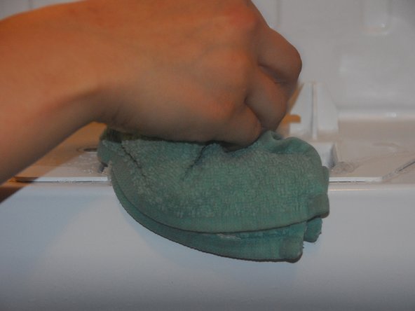

    • Use the blunt end of a tool (e.g., a sharpening steel or the handle of a wooden spoon) to unclog ice from the dispensing chute.
    • Be careful to not scratch or otherwise damage the dispensing chute with the tool, as this can lead to interruptions in the dispensing of ice.
    • Wipe away any remaining ice with a warm cloth.

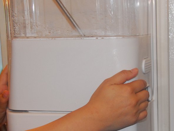

    • Return the ice bucket to the freezer.
    • If the ice bucket does not seat securely, rotate the auger slightly.
    • Once the auger is aligned with the motor coupler, place the ice bucket on top of the motor surface.
    • Let the ice bucket cool for 10-15 minutes to cool to its original temperature. This will prevent ice from clogging the dispensing chute once the ice maker is turned on.
    • If you chose to preserve the original ice in Step 3, return it to the ice bucket once the ice has cooled.
