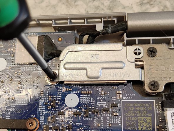

Motherboard Part 1
  • Remove 1 M2x3 screw and lift DP-cable mounting bracket
  • Move cables aside
