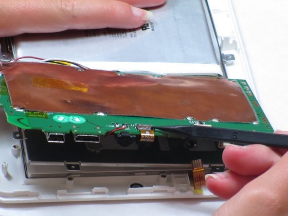

  • Lift up the motherboard.
  • A mesh-looking strip on the left side will be connected to the bottom of the motherboard.
  • Remove the tape on top of the strip and use tweezers or pliers to pull on the strip to unplug it.
