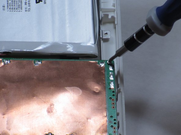

    1. Creative Ziio 7" Motherboard Replacement, Motherboard: crwdns2935265:02crwdnd2935265:01crwdnd2935265:03crwdne2935265:0 Creative Ziio 7" Motherboard Replacement, Motherboard: crwdns2935265:02crwdnd2935265:02crwdnd2935265:03crwdne2935265:0 Creative Ziio 7" Motherboard Replacement, Motherboard: crwdns2935265:02crwdnd2935265:03crwdnd2935265:03crwdne2935265:0
      • Remove the copper plate covering the motherboard by desoldering the ten solder points.
      • The solder point in the bottom right corner is marked but hidden by the soldering iron.

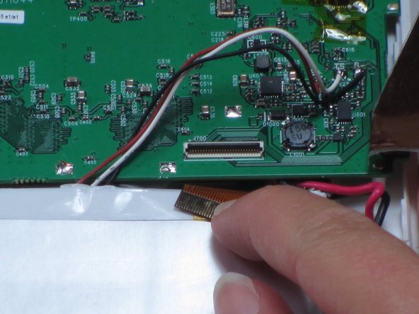

    2. Creative Ziio 7" Motherboard Replacement: crwdns2935265:03crwdnd2935265:01crwdnd2935265:02crwdne2935265:0 Creative Ziio 7" Motherboard Replacement: crwdns2935265:03crwdnd2935265:02crwdnd2935265:02crwdne2935265:0
      • Remove the adhesive tape covering the three wires connected to the motherboard.
      • Desolder the solder points connecting the wires to the motherboard.

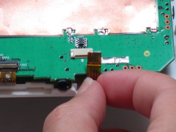

    3. Creative Ziio 7" Motherboard Replacement: crwdns2935265:04crwdnd2935265:01crwdnd2935265:03crwdne2935265:0 Creative Ziio 7" Motherboard Replacement: crwdns2935265:04crwdnd2935265:02crwdnd2935265:03crwdne2935265:0 Creative Ziio 7" Motherboard Replacement: crwdns2935265:04crwdnd2935265:03crwdnd2935265:03crwdne2935265:0
      • Disconnect the ribbon cable that is attached underneath the copper plate.
      • Disconnect the other ribbon cable that is connected next the copper plate in the corner of the circuit board.
    4. Creative Ziio 7" Motherboard Replacement: crwdns2935265:05crwdnd2935265:01crwdnd2935265:02crwdne2935265:0 Creative Ziio 7" Motherboard Replacement: crwdns2935265:05crwdnd2935265:02crwdnd2935265:02crwdne2935265:0
      • Remove the four 4mm Philips #00 screws holding the motherboard to the casing.
      • The copper plate will be removed by now. However, the picture does not show this.

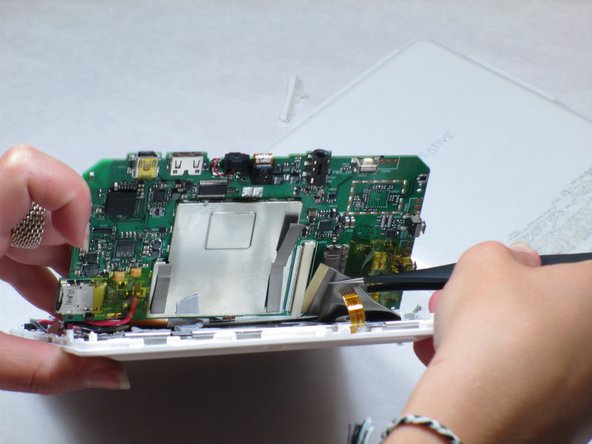

    5. Creative Ziio 7" Motherboard Replacement: crwdns2935265:06crwdnd2935265:01crwdnd2935265:02crwdne2935265:0 Creative Ziio 7" Motherboard Replacement: crwdns2935265:06crwdnd2935265:02crwdnd2935265:02crwdne2935265:0
      • Lift up the motherboard.
      • A mesh-looking strip on the left side will be connected to the bottom of the motherboard.
      • Remove the tape on top of the strip and use tweezers or pliers to pull on the strip to unplug it.

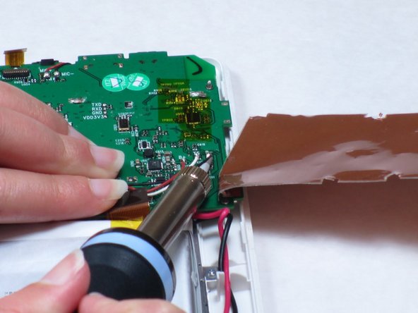

    6. Creative Ziio 7" Motherboard Replacement: crwdns2935265:07crwdnd2935265:01crwdnd2935265:01crwdne2935265:0
      • Remove the red and black wires with a soldering iron that are located underneath the motherboard.
      • Do not cut or damage the wires in the process. They will be needed for the new motherboard.
    7. Creative Ziio 7" Motherboard Replacement: crwdns2935265:08crwdnd2935265:01crwdnd2935265:01crwdne2935265:0
      • Remove the old motherboard and dispose of it resposibly.
