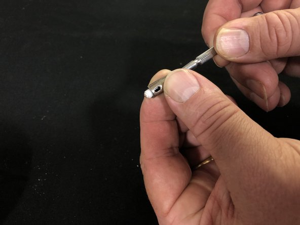

Tip Disassembly (3)
  • Remove the leftover wire cap from inside the tip by sticking a screwdriver through the barrel of the tip.
