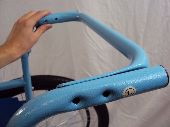

  • Insert the remaining crossbar between the handles, and align the holes on both sides.
  • Secure the crossbar with four [4] blue tipped bolts and rubber tipped nuts (two on each side).
