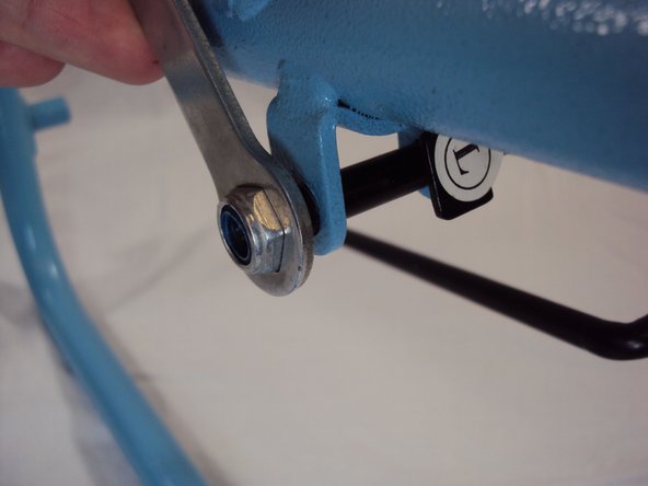

    • Align the left (L) frame piece with the brake hole on the left frame piece.
    • Insert and tighten using one [1] brake bolt.
    • Repeat using the right (R) brake with the right frame piece.

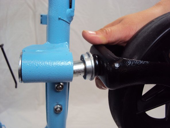

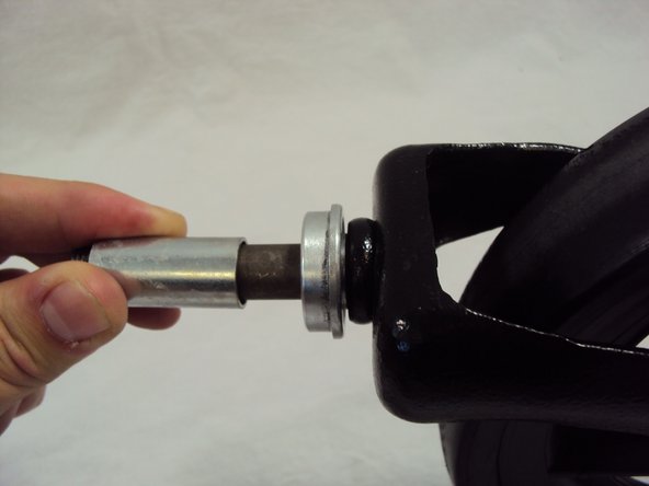

    • Slide the ring-shaped piece of one castor bearing onto the axle of one castor.
    • Slide the metal tube piece onto the axle of the castor.
    • Repeat for the second castor.
  5. Free Wheelchair Mission GEN 2 Assembly: crwdns2935265:05crwdnd2935265:01crwdnd2935265:03crwdne2935265:0 Free Wheelchair Mission GEN 2 Assembly: crwdns2935265:05crwdnd2935265:02crwdnd2935265:03crwdne2935265:0 Free Wheelchair Mission GEN 2 Assembly: crwdns2935265:05crwdnd2935265:03crwdnd2935265:03crwdne2935265:0
    • Slide another ring shaped bearing piece into the castor hole on the frame.
    • Insert the entire castor piece (castor, ring, and tube) into the opposite side of the hole.
    • Secure the castor and bearing pieces with a castor bolt.
    • Repeat on the opposite side of the frame.

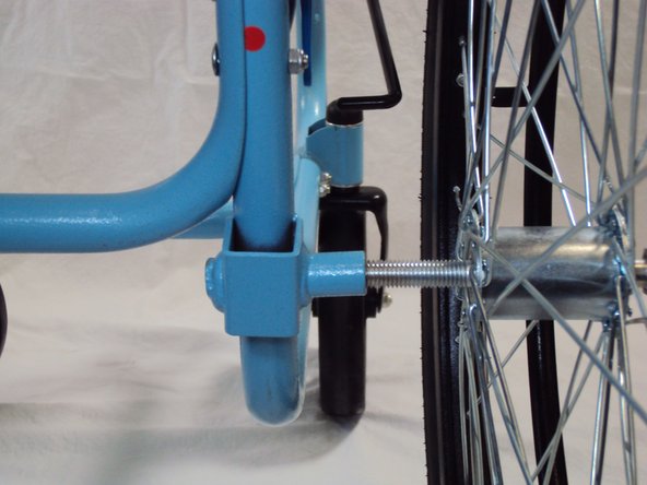

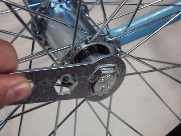

  6. Free Wheelchair Mission GEN 2 Assembly: crwdns2935265:06crwdnd2935265:01crwdnd2935265:03crwdne2935265:0 Free Wheelchair Mission GEN 2 Assembly: crwdns2935265:06crwdnd2935265:02crwdnd2935265:03crwdne2935265:0 Free Wheelchair Mission GEN 2 Assembly: crwdns2935265:06crwdnd2935265:03crwdnd2935265:03crwdne2935265:0

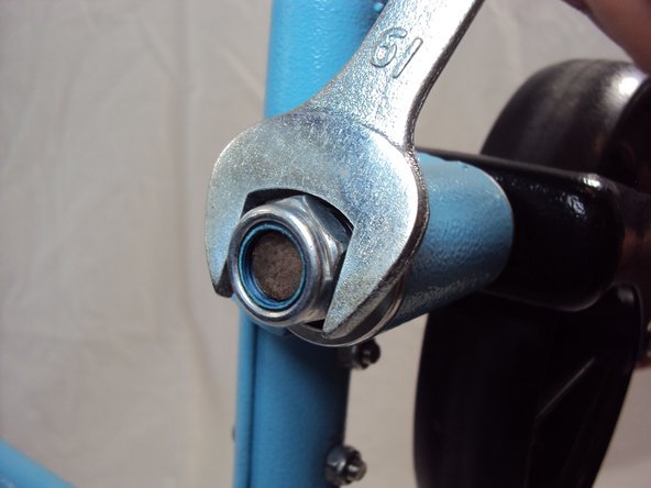

    • Insert an axle bolt through the center of a rear wheel.
    • Insert the axle bolt with wheel into the axle hole on the frame.
    • Tighten the axle bolt.
    • Secure the wheel with a bolt on the opposite side of the hole.
    • Repeat on the opposite side of the frame to attach the other wheel.

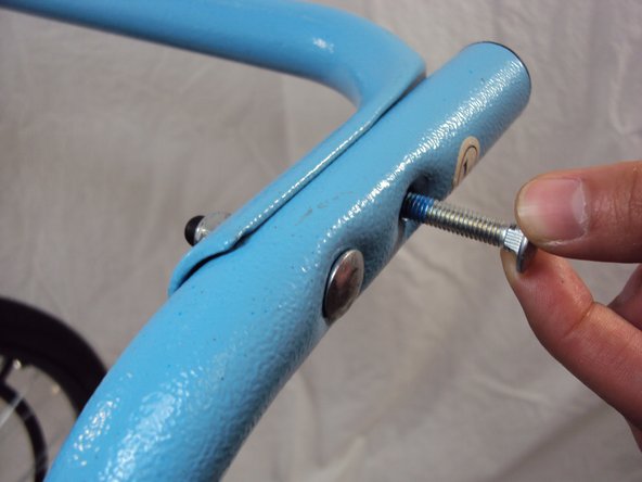

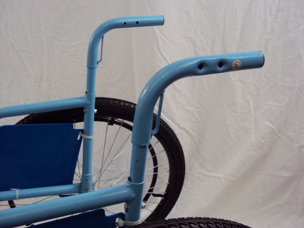

  7. Free Wheelchair Mission GEN 2 Assembly: crwdns2935265:07crwdnd2935265:01crwdnd2935265:03crwdne2935265:0 Free Wheelchair Mission GEN 2 Assembly: crwdns2935265:07crwdnd2935265:02crwdnd2935265:03crwdne2935265:0 Free Wheelchair Mission GEN 2 Assembly: crwdns2935265:07crwdnd2935265:03crwdnd2935265:03crwdne2935265:0
    • Slide each handle into the respective slot on the top of the wheelchair.
    • Adjust the handles up or down to your desired height.
    • Secure the handles in place with one bolt and nut for each side.

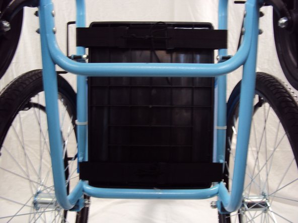

  9. Free Wheelchair Mission GEN 2 Assembly: crwdns2935265:09crwdnd2935265:01crwdnd2935265:02crwdne2935265:0 Free Wheelchair Mission GEN 2 Assembly: crwdns2935265:09crwdnd2935265:02crwdnd2935265:02crwdne2935265:0

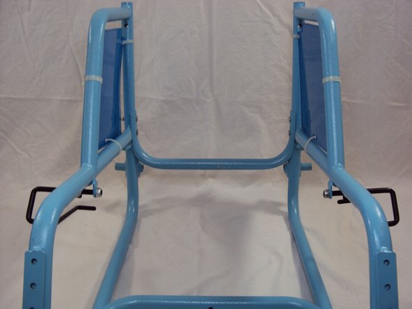

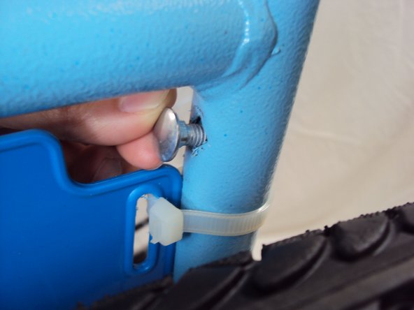

    • Orient the plastic seat with the smooth side up.
    • The rear strap can be attached to the seat in one of three positions in order to accommodate for people of different heights.
    • Loop the straps over the bars of the frame on either side.
    • Rotate the wheelchair onto its back side.
    • Secure the seat by tying each strap together.
    • Make sure that the straps are tied tightly so that the seat does not fall off the wheelchair.

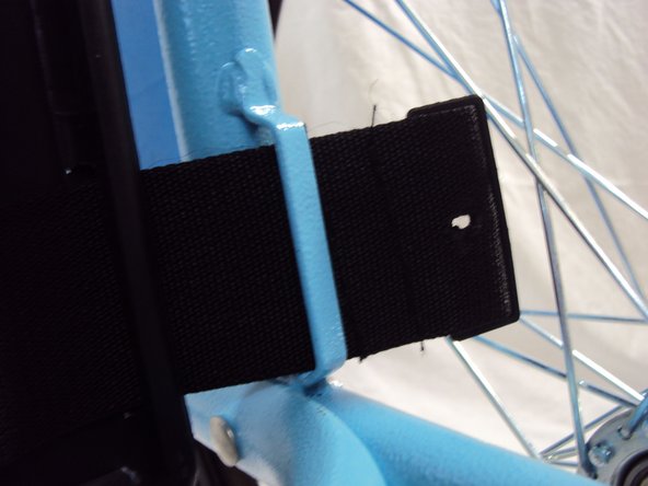

    • Place the bottom of the backrest against the back of the seat cushion.
    • Loop each strap behind the vertical bars of the frame.
    • Secure the backrest by tying each strap together.
    • Make sure that the straps are tied tightly so that the backrest does not fall off the wheelchair.

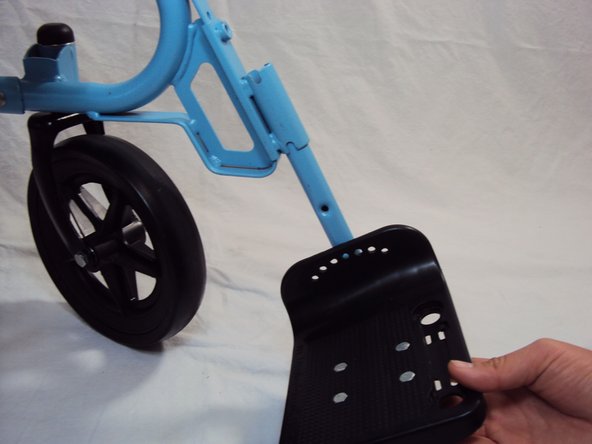

  12. Free Wheelchair Mission GEN 2 Assembly: crwdns2935265:012crwdnd2935265:01crwdnd2935265:03crwdne2935265:0 Free Wheelchair Mission GEN 2 Assembly: crwdns2935265:012crwdnd2935265:02crwdnd2935265:03crwdne2935265:0 Free Wheelchair Mission GEN 2 Assembly: crwdns2935265:012crwdnd2935265:03crwdnd2935265:03crwdne2935265:0

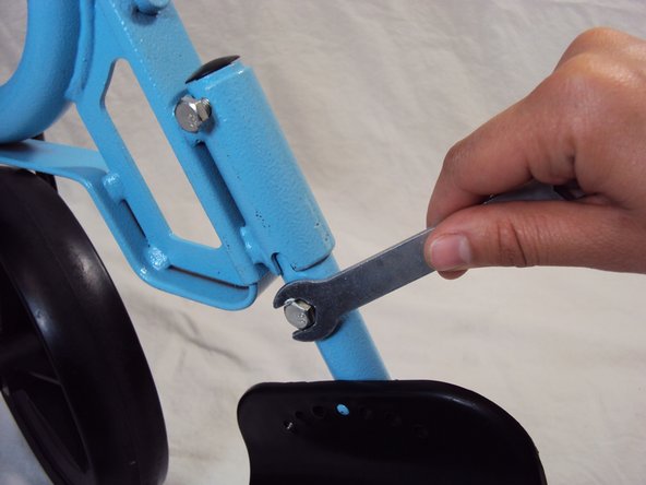

    • Slide a footrest socket over the rail located near the front of the seat.
    • Insert a footrest through the bottom of the footrest socket.
    • Secure the footrest with a bolt above and below the socket.
    • Adjust the footrest socket to your desired height.
    • Align the socket's bolt with the nearest hole in the rail, and tighten the bolt.
    • Repeat this step on the opposite rail.
