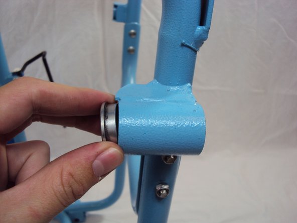

  • Slide another ring shaped bearing piece into the castor hole on the frame.
  • Insert the entire castor piece (castor, ring, and tube) into the opposite side of the hole.
  • Secure the castor and bearing pieces with a castor bolt.
  • Repeat on the opposite side of the frame.
