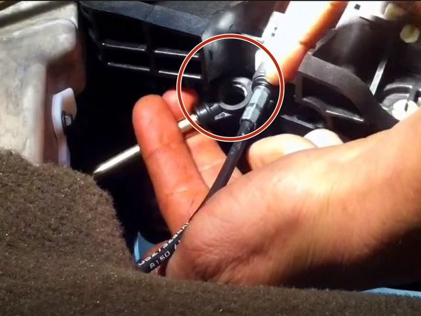

Installing the New Bushing
  • Now you need to be under the shifter bezel on the floorboard. If you follow the rod coming from the transmission, you will see it is not attached to anything.
  • You will see a hole within the rod. That is where your bushing should be. You will push the bushing from the back side of the rod towards the driver side. The bushing should then be facing the driver side. You may need to put a little grease on it as it will be a little difficult to push in. Pliers will help you push it in also.
  • Now that you have the bushing installed, you will reach into the mechanism and clip it in towards the passenger side.
