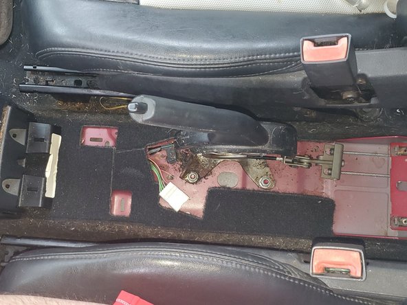

Removing the Middle and Back Sections of the Console
  • Pull the middle and back section back and away from the rest of the console. Completely removing it. You may or may not have some electrical wires you will have to disconnect. It depends on your car's model.
  • You do not have to disconnect this connector from the cigarette lighter.
