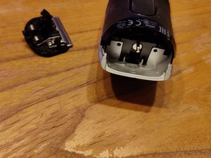

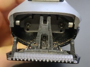

      crwdns2936071:01crwdne2936071:0 — Remove the trim head
      Fold down the trim head
      crwdns2936071:02crwdne2936071:0 — Opening of the housing
      Unscrew the 2 screws at the front under the blade.

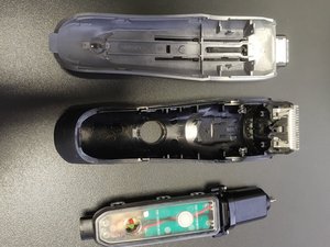

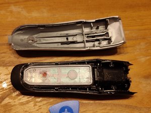

      crwdns2936071:03crwdne2936071:0 — Opening of the housing
      Use the iFixit picks or a similar tool to run along the edge between the top and bottom pieces to loosen the retaining clips.
      crwdns2936071:04crwdne2936071:0 — Opening of the waterproof inside assembly
      With gentle pressure from the opposite side, you can carefully remove the inner module and motor from the housing.

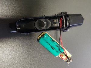

      crwdns2936071:05crwdne2936071:0 — Replacing the batteries
      Carefully lever the PCB up and out. The PCB is held by 2 small hooks approximately in the middle. Spread the housing slightly while you carefully lift out the PCB, e.g. using a small screwdriver on the batteries.
      crwdns2936071:06crwdne2936071:0 — Solder new batteries in place
      If your replacement batteries does not come with its own flags, you still have to unsolder the original flags from the batteries. That doesn't work so well. It is better to use new ones.

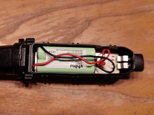

      crwdns2936071:07crwdne2936071:0 — New batteries installed
      Lay the cables to the motor past the LEDs
