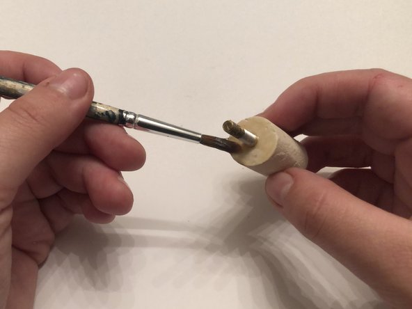

  • Use a small paintbrush to paint a layer of polyurethane glue onto the top of the cork.
  • Do not use contact cement for this step because it will bind on contact and the washer needs to be screwed on.
  • Screw the washer onto the screw rod.
  • Wait for all the glues to dry.
