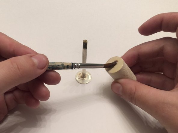

  • Use a small paintbrush to brush on a layer of contact cement onto the bottom of the new cork and the bottom of the screw set up.
  • Let contact cement sit for a few minutes and then slide the cork down onto the screw rod glue side first.
