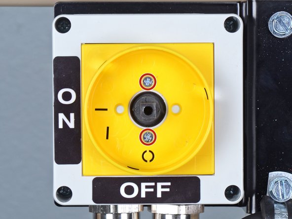

  • Use a Phillips screwdriver to remove the two screws securing the yellow switch guide to the switch assembly.
  • During reassembly, ensure this component is installed in the same orientation, with the circle in the 6 o'clock "OFF" position.
