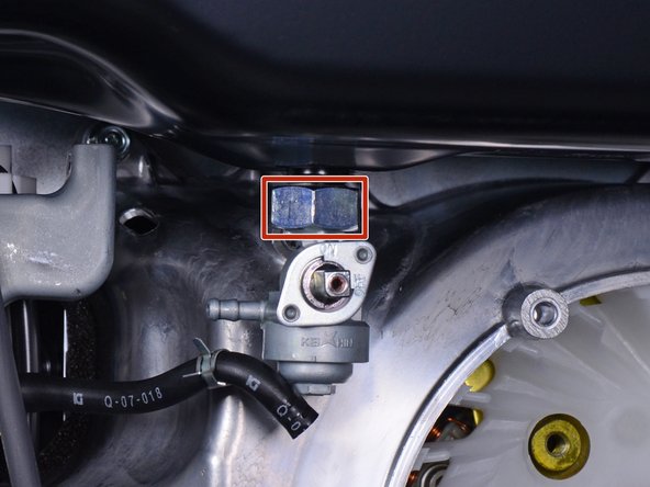

  • Be sure to drain the fuel tank before you perform this step.
  • Use a large crescent wrench to loosen the petcock assembly from the fuel tank.
  • Residual fuel will leak out as you remove the petcock assembly. Be ready to catch any spillage.
  • Remove the petcock assembly.
