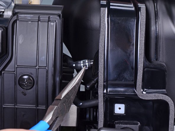

  • Use a pair of pliers to squeeze and slide the spring clip off the fuel pump port.
