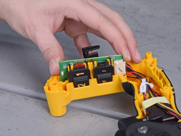

Dewalt Nailer DCN21PL 2018 Opening Procedure, Remove board and switches: crwdns2935265:00crwdnd2935265:01crwdnd2935265:03crwdne2935265:0 Dewalt Nailer DCN21PL 2018 Opening Procedure, Remove board and switches: crwdns2935265:00crwdnd2935265:02crwdnd2935265:03crwdne2935265:0 Dewalt Nailer DCN21PL 2018 Opening Procedure, Remove board and switches: crwdns2935265:00crwdnd2935265:03crwdnd2935265:03crwdne2935265:0
  • The two switches and four detent springs are only held in place by the plastic casing, so they may fall out when you remove the board—this is fine.
  • Grasp either side of the main circuit board and slowly pull it up and out of the slot in the casing.
  • Reassembly tip: note the correct location and orientation of the two switches and their detent springs.
