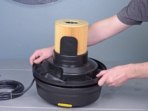

Disconnect the motor
  • Carefully lift the motor/filter away from the housing until you can access the motor wires.
  • Do not separate the motor/filter from the assembly completely, or you risk damaging the motor wires.
