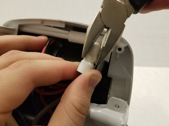

  • Trace the two grey cables of the ACLI plug to their white wire connectors. Pinch the wire connector and pull out the wire connector with pliers.
  • Keep record of which independent wire went to which wire connector.
