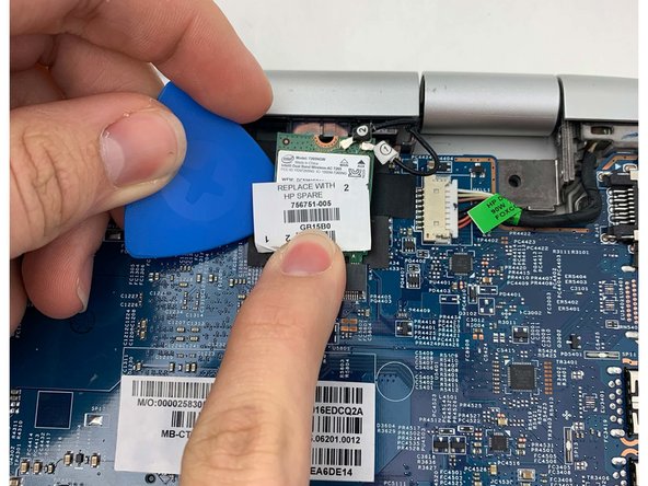

  • Push the chip up with the pick and forward to remove it from the port it is sitting in.
  • Take the precision tweezers and pull the two snap wires off of the chip.
  • The wires have snap connectors for easy replacement and removal.
  • Remove the Wi-Fi Card from the device.
