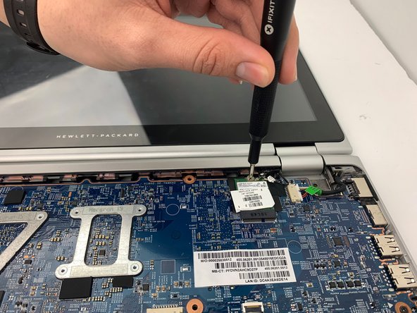

  4. HP Envy x360 m6-w105dx Wi-Fi Card Replacement, Wi-Fi Card: crwdns2935265:04crwdnd2935265:01crwdnd2935265:03crwdne2935265:0 HP Envy x360 m6-w105dx Wi-Fi Card Replacement, Wi-Fi Card: crwdns2935265:04crwdnd2935265:02crwdnd2935265:03crwdne2935265:0 HP Envy x360 m6-w105dx Wi-Fi Card Replacement, Wi-Fi Card: crwdns2935265:04crwdnd2935265:03crwdnd2935265:03crwdne2935265:0
    • Take the #1 Phillips screwdriver and unscrew the 0.4mm silver screw holding down the wireless card.

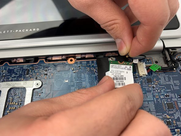

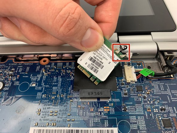

    • Push the chip up with the pick and forward to remove it from the port it is sitting in.
    • Take the precision tweezers and pull the two snap wires off of the chip.
    • The wires have snap connectors for easy replacement and removal.
    • Remove the Wi-Fi Card from the device.
