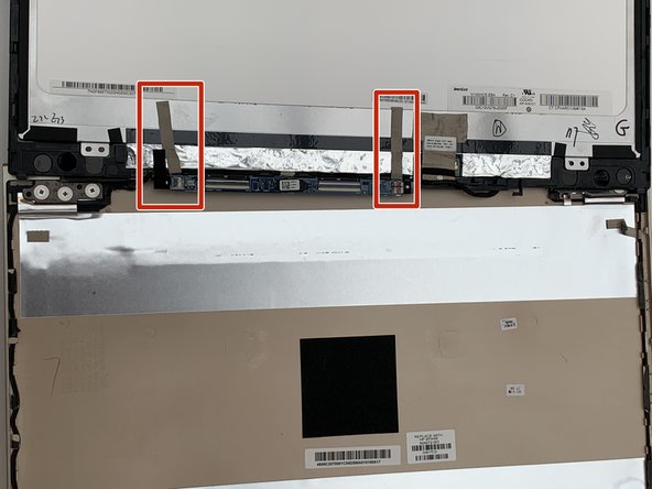

  • Using the Blunt Tweezers, remove the two grey pieces of tape that cover the cable.
  • There is a third piece of tape secured around the wire. This piece of tape should come out easily when the wire is pulled out in the next step, so there is no need to remove it here.
