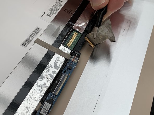

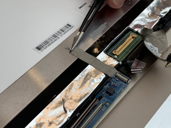

  14. HP Pavilion x360 14m-ba114dx Screen Assembly Replacement: crwdns2935265:014crwdnd2935265:01crwdnd2935265:03crwdne2935265:0 HP Pavilion x360 14m-ba114dx Screen Assembly Replacement: crwdns2935265:014crwdnd2935265:02crwdnd2935265:03crwdne2935265:0 HP Pavilion x360 14m-ba114dx Screen Assembly Replacement: crwdns2935265:014crwdnd2935265:03crwdnd2935265:03crwdne2935265:0
    • Using the Blunt Tweezers, remove the large piece of gray tape over the LCD Display connector.
    • This tape is located on the back of the screen assembly, on the bottom and near the hinges.

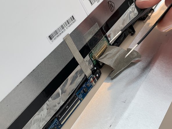

  15. HP Pavilion x360 14m-ba114dx Screen Assembly Replacement: crwdns2935265:015crwdnd2935265:01crwdnd2935265:02crwdne2935265:0 HP Pavilion x360 14m-ba114dx Screen Assembly Replacement: crwdns2935265:015crwdnd2935265:02crwdnd2935265:02crwdne2935265:0
    • Using the Blunt Tweezers, remove the clear tape over the LCD Display connector.
    • The LCD display connector is not a ZIF connector and it will slide out easily as you remove the second piece of tape.
    • If the connector does not slide out, the Blunt Tweezers can be used to gently pull it out of place.

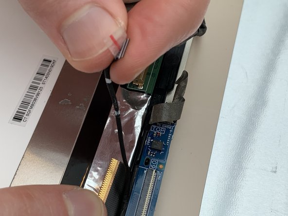

  16. HP Pavilion x360 14m-ba114dx Screen Assembly Replacement: crwdns2935265:016crwdnd2935265:01crwdnd2935265:02crwdne2935265:0 HP Pavilion x360 14m-ba114dx Screen Assembly Replacement: crwdns2935265:016crwdnd2935265:02crwdnd2935265:02crwdne2935265:0

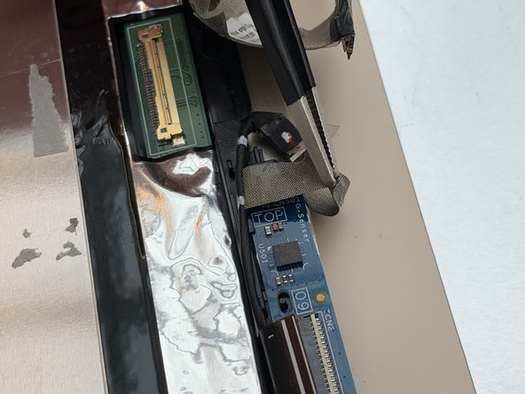

    • Using the Blunt Tweezers, remove the black tape covering the connection cable between the screen and the rest of the laptop.
  17. HP Pavilion x360 14m-ba114dx Screen Assembly Replacement: crwdns2935265:017crwdnd2935265:01crwdnd2935265:03crwdne2935265:0 HP Pavilion x360 14m-ba114dx Screen Assembly Replacement: crwdns2935265:017crwdnd2935265:02crwdnd2935265:03crwdne2935265:0 HP Pavilion x360 14m-ba114dx Screen Assembly Replacement: crwdns2935265:017crwdnd2935265:03crwdnd2935265:03crwdne2935265:0

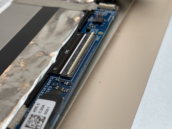

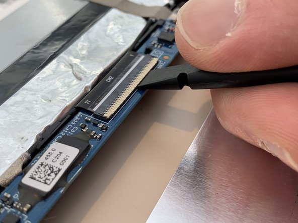

  18. HP Pavilion x360 14m-ba114dx Screen Assembly Replacement: crwdns2935265:018crwdnd2935265:01crwdnd2935265:03crwdne2935265:0 HP Pavilion x360 14m-ba114dx Screen Assembly Replacement: crwdns2935265:018crwdnd2935265:02crwdnd2935265:03crwdne2935265:0 HP Pavilion x360 14m-ba114dx Screen Assembly Replacement: crwdns2935265:018crwdnd2935265:03crwdnd2935265:03crwdne2935265:0
    • Using the pointed end of a #3 Plastic Spudger, flip the cap on the two ZIF connectors that attach the motherboard to the gravity induction line and the touch line.
    • After flipping the cap, gently pull the connectors out of their slots.
  19. HP Pavilion x360 14m-ba114dx Screen Assembly Replacement: crwdns2935265:019crwdnd2935265:01crwdnd2935265:03crwdne2935265:0 HP Pavilion x360 14m-ba114dx Screen Assembly Replacement: crwdns2935265:019crwdnd2935265:02crwdnd2935265:03crwdne2935265:0 HP Pavilion x360 14m-ba114dx Screen Assembly Replacement: crwdns2935265:019crwdnd2935265:03crwdnd2935265:03crwdne2935265:0

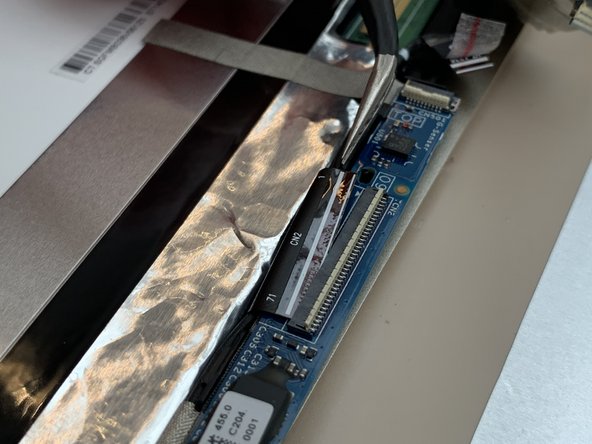

    • Using the flat end of a plastic Spudger, flip up the cap on the two ZIF connectors covering the gravity induction line and the touch line.

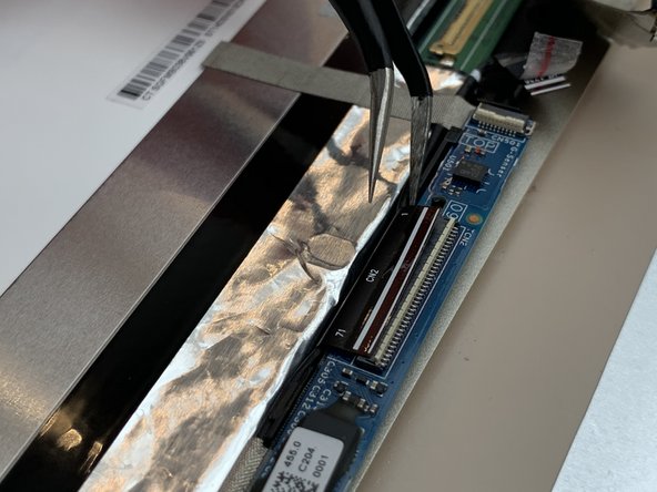

  20. HP Pavilion x360 14m-ba114dx Screen Assembly Replacement: crwdns2935265:020crwdnd2935265:01crwdnd2935265:03crwdne2935265:0 HP Pavilion x360 14m-ba114dx Screen Assembly Replacement: crwdns2935265:020crwdnd2935265:02crwdnd2935265:03crwdne2935265:0 HP Pavilion x360 14m-ba114dx Screen Assembly Replacement: crwdns2935265:020crwdnd2935265:03crwdnd2935265:03crwdne2935265:0
    • Using the Angled Tweezers, pull the ZIF connectors out of their housing.

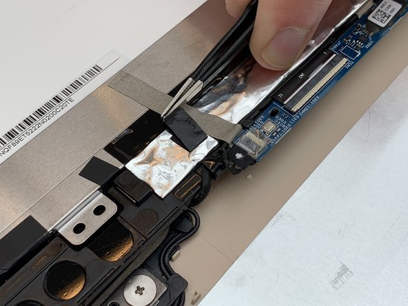

  21. HP Pavilion x360 14m-ba114dx Screen Assembly Replacement: crwdns2935265:021crwdnd2935265:01crwdnd2935265:03crwdne2935265:0 HP Pavilion x360 14m-ba114dx Screen Assembly Replacement: crwdns2935265:021crwdnd2935265:02crwdnd2935265:03crwdne2935265:0 HP Pavilion x360 14m-ba114dx Screen Assembly Replacement: crwdns2935265:021crwdnd2935265:03crwdnd2935265:03crwdne2935265:0
    • Using the Blunt Tweezers, remove the two grey pieces of tape that cover the cable.
    • There is a third piece of tape secured around the wire. This piece of tape should come out easily when the wire is pulled out in the next step, so there is no need to remove it here.

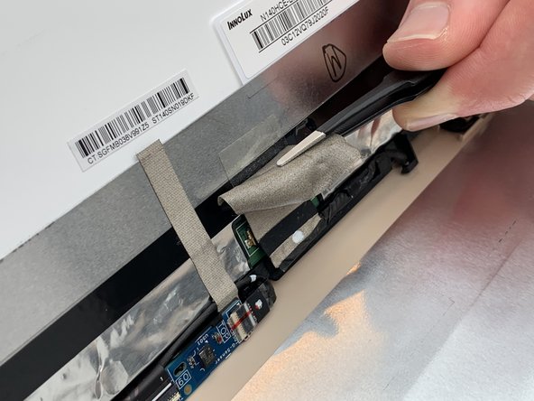

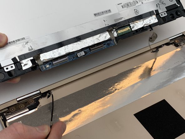

  22. HP Pavilion x360 14m-ba114dx Screen Assembly Replacement: crwdns2935265:022crwdnd2935265:01crwdnd2935265:03crwdne2935265:0 HP Pavilion x360 14m-ba114dx Screen Assembly Replacement: crwdns2935265:022crwdnd2935265:02crwdnd2935265:03crwdne2935265:0 HP Pavilion x360 14m-ba114dx Screen Assembly Replacement: crwdns2935265:022crwdnd2935265:03crwdnd2935265:03crwdne2935265:0
    • Slowly pull the cable out of its track. (You may need to use the tweezers to grab the cable if it is stuck under a plastic piece in the track).
    • This cable is secured around many plastic notches in the casing. You should be able to pull out the cable, just do it slowly and be mindful of the areas where it may get caught.
    • After removing the cable, remove the screen assembly from the laptop casing.
