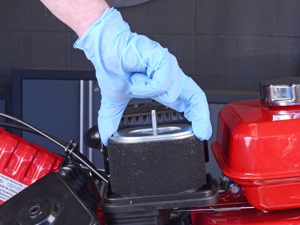

Air Filter Removal

  • Wear gloves or use a rag during this step, as the air filter is coated with oil.
  • Lift the air filter straight up off the elbow, making sure it clears the threaded rod.
