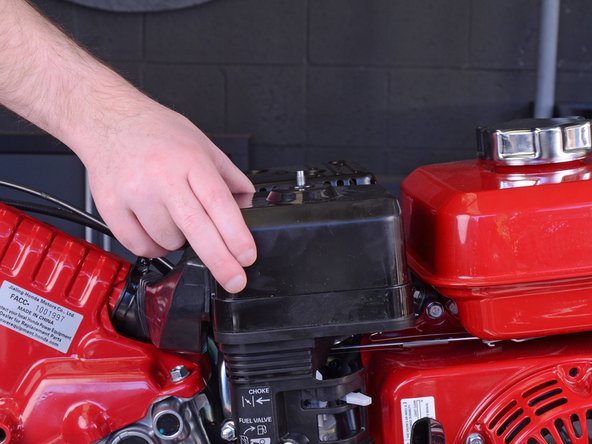

  1. Air Filter Removal, Remove the Air Filter Cover: crwdns2935265:01crwdnd2935265:01crwdnd2935265:01crwdne2935265:0
    • Use your fingers to unscrew and remove the wing nut securing the air filter cover to the air filter elbow.
  2. Air Filter Removal: crwdns2935265:02crwdnd2935265:01crwdnd2935265:02crwdne2935265:0 Air Filter Removal: crwdns2935265:02crwdnd2935265:02crwdnd2935265:02crwdne2935265:0
    • Lift up and remove the air filter cover to reveal the air filter.
    • The air filter cover will still be attached to the tiller by a flexible hose. You can push the cover to the side while you continue to work on the tiller, or follow the next two steps to completely remove the cover.
