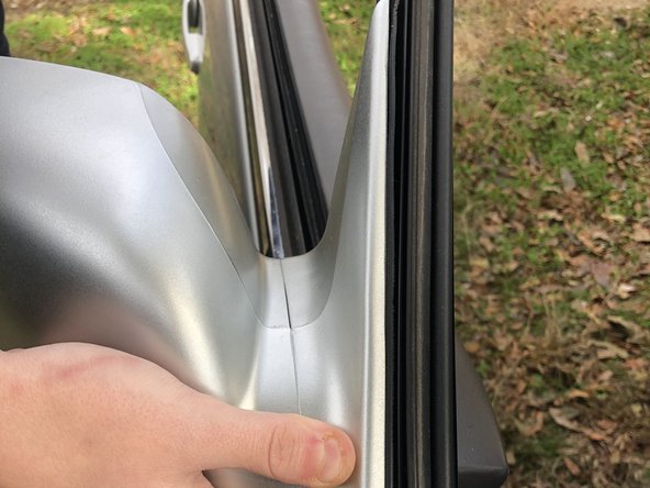

  • Mount the replacement side view mirror.
  • Make sure it is flush with the car.
  • Continue to hold the replacement side mirror in place until you have tightened the 10mm bolts enough to keep it mounted.
