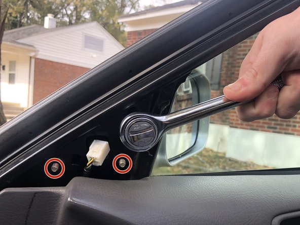

  • Remove the three 10mm bolts using your 10mm socket and ratchet extension.
  • Ensure you are holding the mirror so it does not fall to the ground while removing the bolts.
