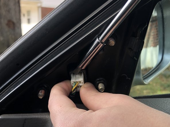

  • Detach the electrical connecter completely. Place your flathead screwdriver in the gap to gain leverage and pull on the connector.
  • Be careful not to pull on the wires.
