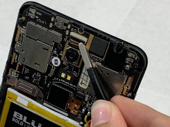

  • Hold the new camera by its brown film piece using the blunt tweezers.
  • Using the blunt tweezers, place the top of the film under the holding ridge and gently push it into the slot.
  • Keep pushing the film into the slot until you can no longer see the white line on the film.
  • Use your fingers to lodge the body of the camera into its housing unit.
