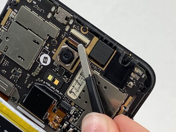

  • Using the flat blunt tweezers, grip the black and brown colored film that is lodged into a slot underneath a black holding ridge that connects the camera to the body of the phone.
  • Gently pull with the blunt tweezers on each side of the black and brown film until it slides out from beneath the ridge. Do this slowly to prevent ripping the film.
  • Keep hold of the film and pull away from the phone to dislodge the camera from its housing unit.
