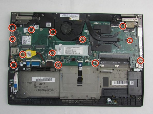

  • Remove the thirteen (13) 4mm screws from the motherboard using the Phillips #00 screwdriver.
  • Remove the nine (9) circled 3mm screws from the fan and the outer edge of the device using the Phillips #00 screwdriver.
