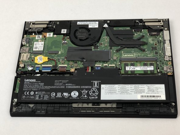

  4. Lenovo ThinkPad Yoga 370 Motherboard Replacement: crwdns2935265:04crwdnd2935265:01crwdnd2935265:02crwdne2935265:0 Lenovo ThinkPad Yoga 370 Motherboard Replacement: crwdns2935265:04crwdnd2935265:02crwdnd2935265:02crwdne2935265:0
    • Gently remove the cover by placing your fingers around the edges.

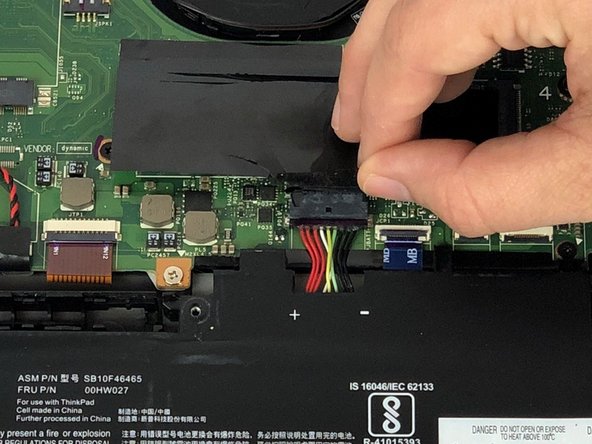

  5. Lenovo ThinkPad Yoga 370 Motherboard Replacement: crwdns2935265:05crwdnd2935265:01crwdnd2935265:03crwdne2935265:0 Lenovo ThinkPad Yoga 370 Motherboard Replacement: crwdns2935265:05crwdnd2935265:02crwdnd2935265:03crwdne2935265:0 Lenovo ThinkPad Yoga 370 Motherboard Replacement: crwdns2935265:05crwdnd2935265:03crwdnd2935265:03crwdne2935265:0

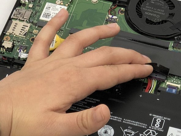

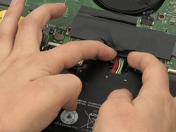

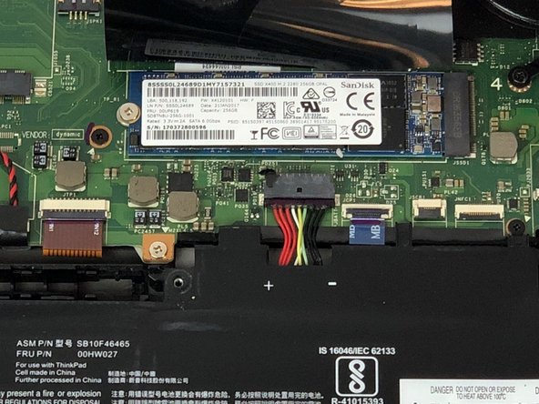

    • With your fingers, fold back the plastic cover highlighted.
    • Using two fingers, gently remove the battery connectors.

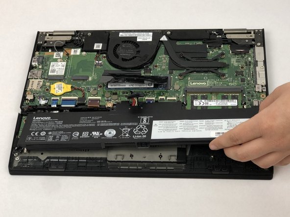

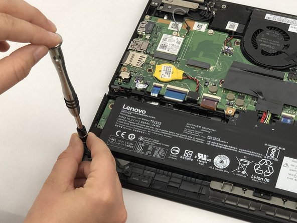

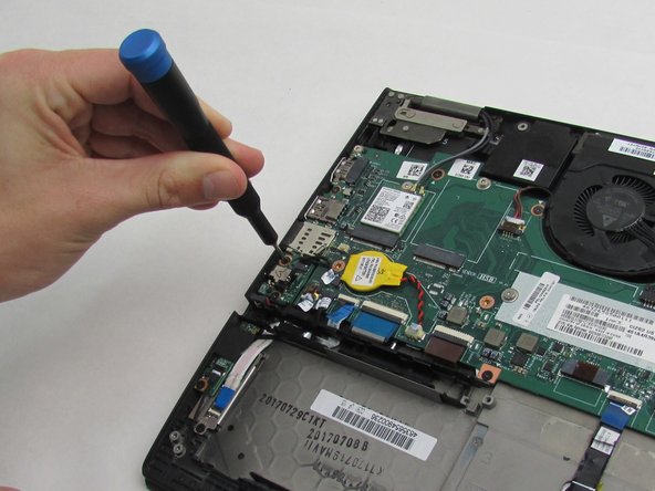

    • Using the Phillips #00 screwdriver, remove the two 4mm screws.
    • Remove the battery.
