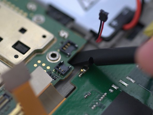

  • Begin prying up the motherboard in the corner nearest the battery. Not much force will be required as the board is completely loose at this point.
  • Next, pry the motherboard up at the top of the device near the left speaker.
  • Once you can get the edge of the board high enough, grab it and lift it up and towards the battery. This will prevent it from snagging on the cable disconnected in step 7.
