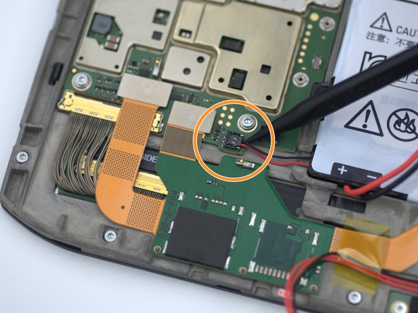

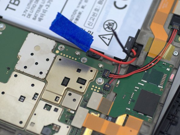

  10. Motorola Xoom 2 MotherBoard Replacement: crwdns2935265:010crwdnd2935265:01crwdnd2935265:02crwdne2935265:0 Motorola Xoom 2 MotherBoard Replacement: crwdns2935265:010crwdnd2935265:02crwdnd2935265:02crwdne2935265:0
    • Disconnect the battery first for safety by unscrewing the two 1.5mm screws with a T5 Torx screwdriver.
    • Following best safety practices, insulate the red positive lead by wrapping the connector with any form of non-conductive tape, such as masking tape or electrical tape.

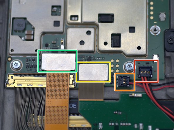

  11. Motorola Xoom 2 MotherBoard Replacement: crwdns2935265:011crwdnd2935265:01crwdnd2935265:02crwdne2935265:0 Motorola Xoom 2 MotherBoard Replacement: crwdns2935265:011crwdnd2935265:02crwdnd2935265:02crwdne2935265:0
    • The following steps will take place within the outlined red sector.
    • The connectors will be removed in this order: red, orange, yellow, then green.
  12. Motorola Xoom 2 MotherBoard Replacement: crwdns2935265:012crwdnd2935265:01crwdnd2935265:02crwdne2935265:0 Motorola Xoom 2 MotherBoard Replacement: crwdns2935265:012crwdnd2935265:02crwdnd2935265:02crwdne2935265:0
    • Begin by removing this three-wire connector with a spudger or similar pry tool as shown.
    • Next remove the smaller two-wire connector in the same way as the first.
    • The connectors come out by being pulled up and not pulled out.

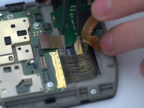

  13. Motorola Xoom 2 MotherBoard Replacement: crwdns2935265:013crwdnd2935265:01crwdnd2935265:01crwdne2935265:0
    • Using a prying tool or a spudger, disconnect the following connectors by applying upward force from underneath the connections.
    • Be gentle when pulling the connections out, making sure not to damage any.

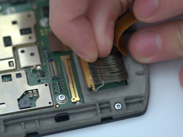

  14. Motorola Xoom 2 MotherBoard Replacement: crwdns2935265:014crwdnd2935265:01crwdnd2935265:03crwdne2935265:0 Motorola Xoom 2 MotherBoard Replacement: crwdns2935265:014crwdnd2935265:02crwdnd2935265:03crwdne2935265:0 Motorola Xoom 2 MotherBoard Replacement: crwdns2935265:014crwdnd2935265:03crwdnd2935265:03crwdne2935265:0
    • Using your fingers, gently pull back the connector. Using tweezers pull up the 'handle' of the connector located underneath. This handle is resting in front of the yellow-gold metal strip where the wires meet.
    • Once the handle has been pulled up and rotated back to a more accessible position, you will be able to grab it with your fingers. Pull the handle back to disconnect it from the device.

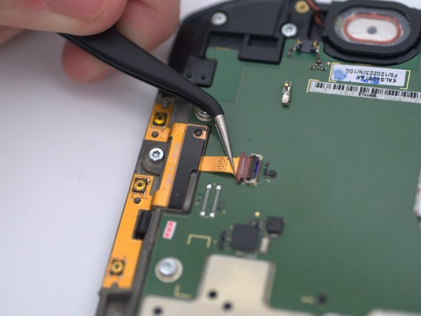

  15. Motorola Xoom 2 MotherBoard Replacement: crwdns2935265:015crwdnd2935265:01crwdnd2935265:02crwdne2935265:0 Motorola Xoom 2 MotherBoard Replacement: crwdns2935265:015crwdnd2935265:02crwdnd2935265:02crwdne2935265:0
    • Using a pair of tweezers, carefully pry up the black plastic connector holding the cable.

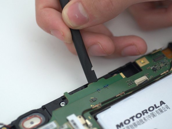

    • Begin prying up the motherboard in the corner nearest the battery. Not much force will be required as the board is completely loose at this point.
    • Next, pry the motherboard up at the top of the device near the left speaker.
    • Once you can get the edge of the board high enough, grab it and lift it up and towards the battery. This will prevent it from snagging on the cable disconnected in step 7.
