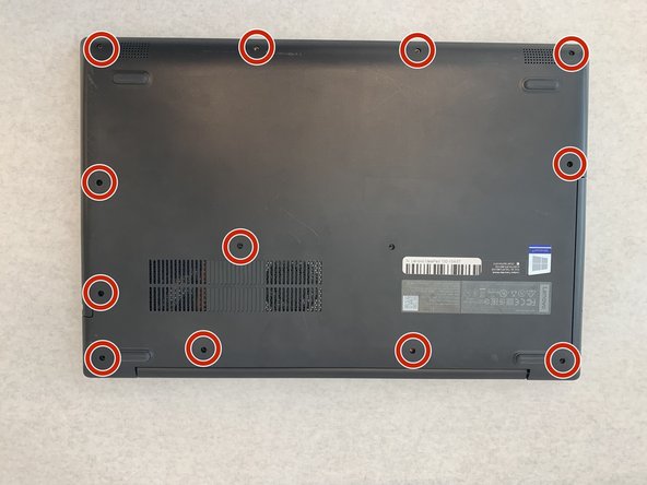

  • Before you proceed, make sure your computer is turned off and it is not connected to any power source.
  • Using a Phillips #1 screwdriver, remove 12 6mm screws.
