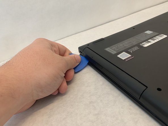

  2. Lenovo IdeaPad 130-15AST Cooling Fan Replacement: crwdns2935265:02crwdnd2935265:01crwdnd2935265:02crwdne2935265:0 Lenovo IdeaPad 130-15AST Cooling Fan Replacement: crwdns2935265:02crwdnd2935265:02crwdnd2935265:02crwdne2935265:0
    • Using the Jimmy Tool, gently pry the DVD/CD Drive away from the case of the laptop.

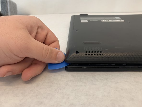

    • Do not try to completely remove this case without ensuring the entire case is free of connection points as this could crack or damage the case.
    • Use a thin, flat edge to gently break the seal of the case.

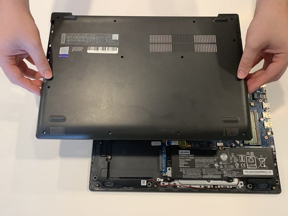

    • Make sure that the back panel is completely free from the laptop.
    • Grab the sides of the back panel of the laptop with two hands. Then separate the panel from the laptop by lifting up. Place the panel aside from the laptop.

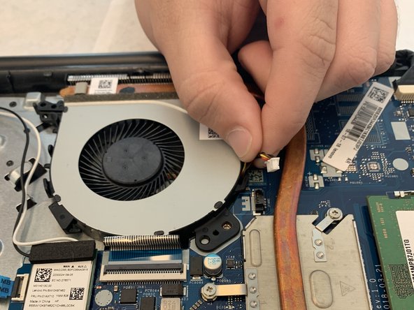

    • Gently move the wires wrapped around the fan that run along the left side of the cooling fan.
    • These wires are not connected directly to the fan and should not be removed but simply displaced from their original location.

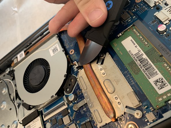

    • Gently use a prying tool to disconnect the cooling fan from the motherboard.
    • After disconnecting the cooling fan, remove the fan from the laptop.
