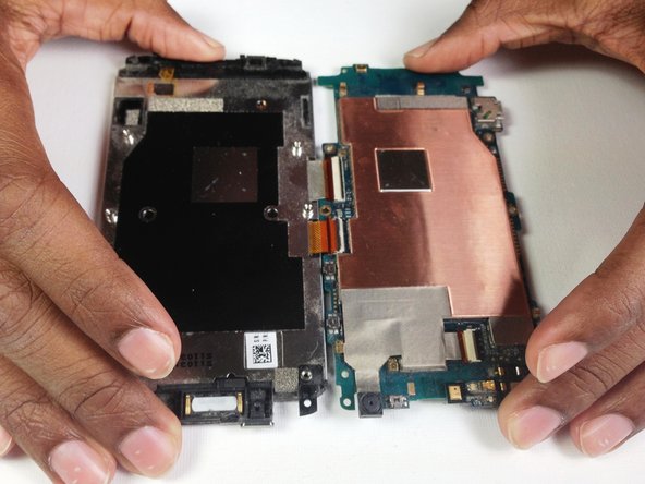

  • Once the tabs have been popped up, slowly pull the two pieces away from each other.
  • If there is resistance pulling apart the phone then a ribbon or tab has not been disconnected properly/completely.
